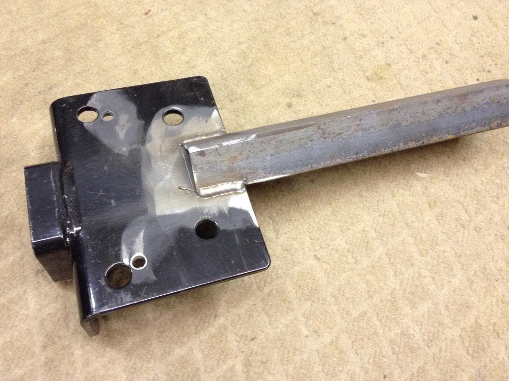

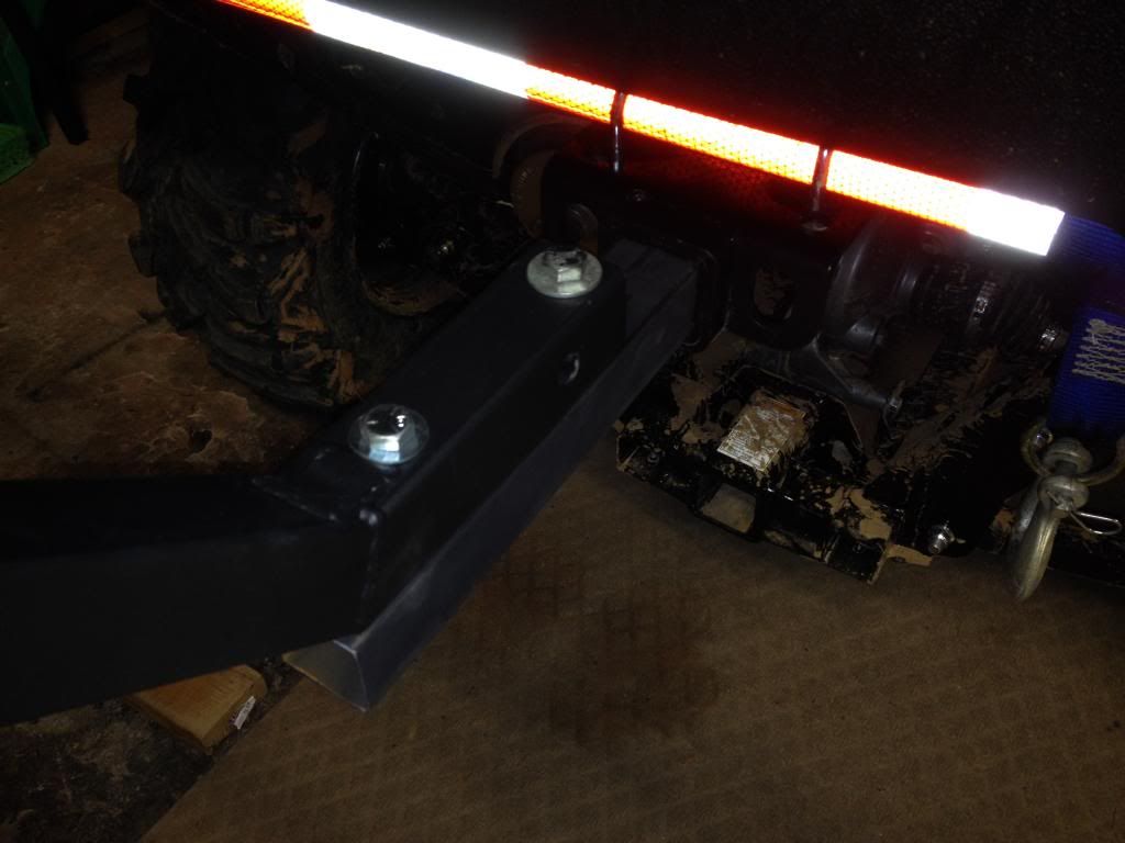

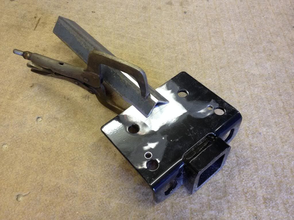

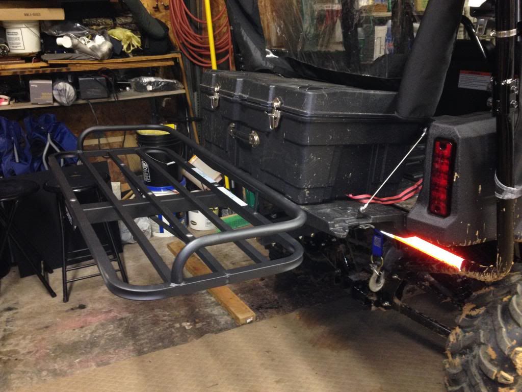

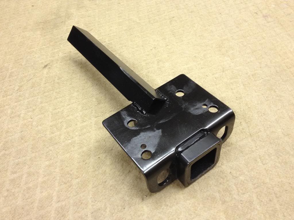

skorp, I noticed that the cross member has holes in it. I think I'm going to drill the angle and bolt it to the cross member. Just for a little added strength.
Discussion Starter · #19 ·
what about bed tilt working the clamps?
Not sure what you mean. I am able to tilt the bed with the receiver installed. I might not be able to with a platform attached though but I not sure I'd ever need to. I might try it just so I know.
664 Posts
that's what I was wondering if you mounted the angle iron to bed you wont be able to dump unless you unhook the angle iron from the bed. I do like that setup and will be coping it.
