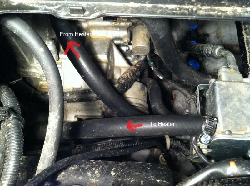

Following others suggestions- I hooked my heater hoses into the return line from the oil cooler. I just removed the 12" long or so 3/4" hose between engine and oil cooler, and stuck my heater hoses there.
FYI, it took me roughly 12-13 feet of hose to make 2 lines that reached from engine to the heater core

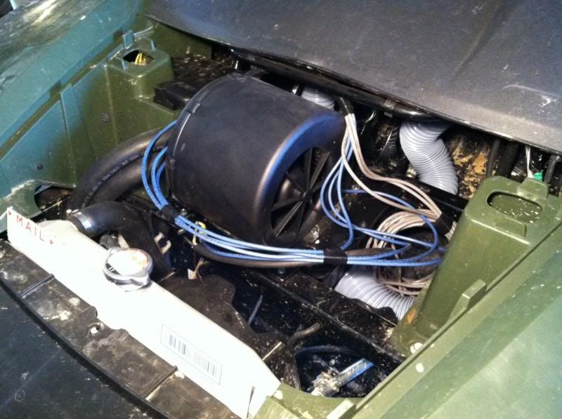

My wirings still a little messy- Its been record low temps here and I wanted to get it working!

My heater is home made, http://hondasxs.com/accessories-and-modifications-f48/assembling-the-heater-t581.html
