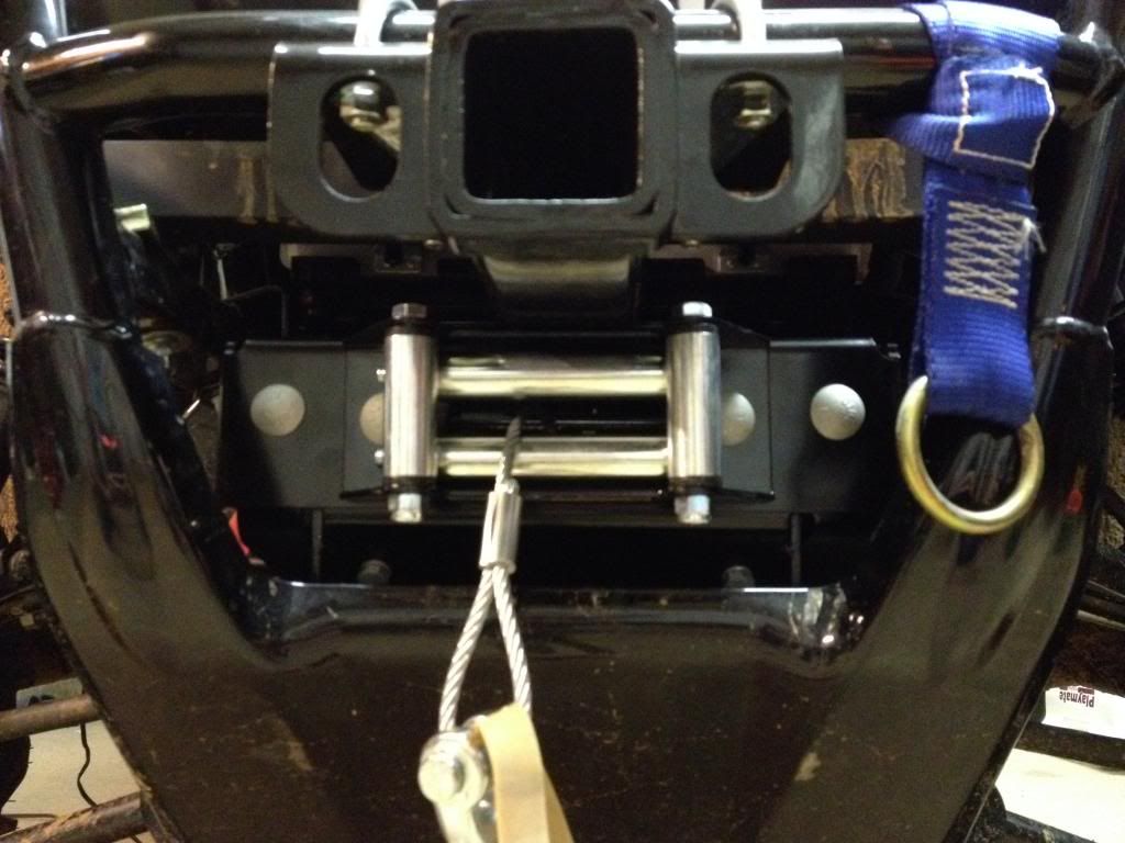

Duwop I had just enough room for my 2" receiver above my winch. I used u-bolts and it seems to work pretty well.
I got that receiver at northern tool. I had to add a piece or angle iron behind it so the receiver wouldn't spin on the bumper tube even with the u bolts tight.
I hope this helps.
