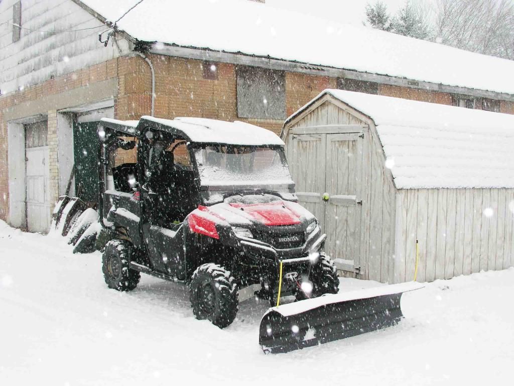

I have the Eagle plow here in Pa. That is about all I have got done in the past 3 weeks. I love the eagle plow and I really like there mount. Between me and my son we have almost 70 miles on just plowing. The pioneer does an awesome job.

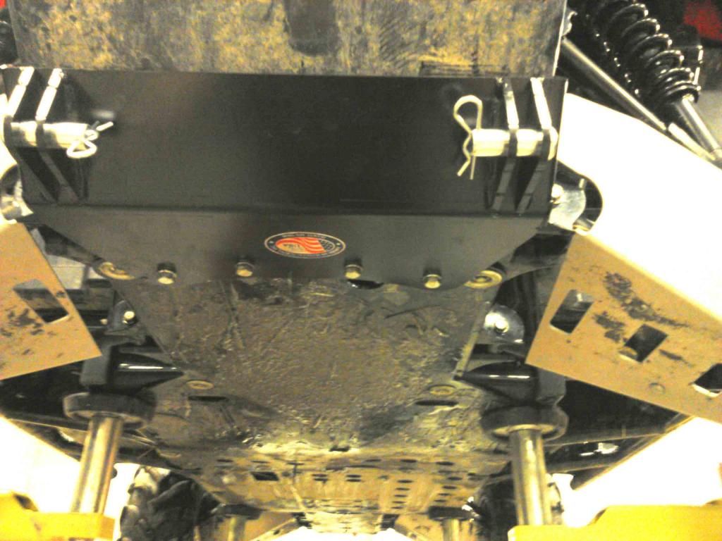

bfair is the plastic skid plate sandwiched between the mount and the bracket all that is holding the back bolts on this mount?
The plate clamps on the one that rolls down around front. I spent 2 hours today plowing with it. It was wet heavy snow. The mount holds up well. I back drag with it over gravel so I don't push it all off. I don't baby it and it is holding up very well. I have snow piled up 5 feet high.I like the ability to take it on and off in about 2 minutes.

Here is a photo of the plate.
I don't think you loose any ground clearance. It doesn't stick out any further.

At 67 I like to make things easy for me. I have done a lot of plowing with it and no problems. The blade has kicked over quite a few times ( from me hitting things Duhh ) with every thing still tight.
