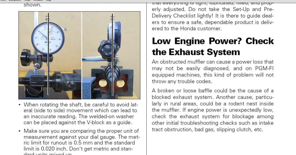

Not everything Dick... lol I'm guessing Honda has had some internal weld problems in the exhaust systems since last months new letter mentioned just that problem. Lack of power to check the exhaust. I have had a few 4 wheelers in the past with bad welds but those was on the intake pipes. I'm going to guess there aren't going to be too many of these problems, but if there is Honda will issue an update for the problem.

I rambled on long enough... lol I'll try to get that article posted here a little later.
