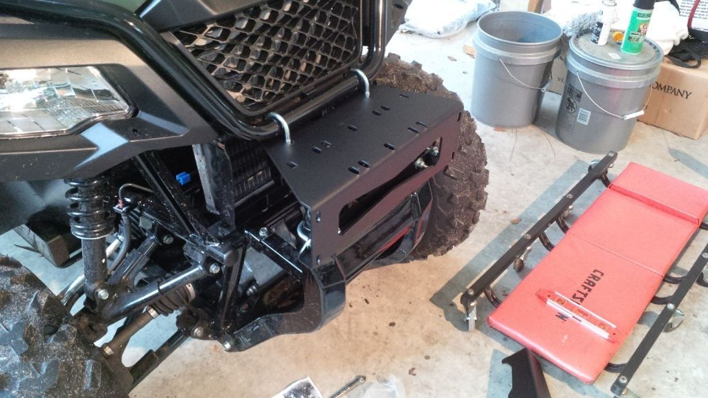

The bottom bracket attaches to the stock front bumper and hood roll bar using u-bolts

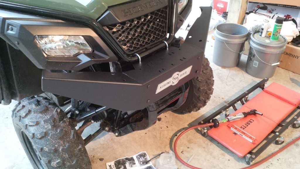

Here is the actual bumper mounted over the bottom bracket

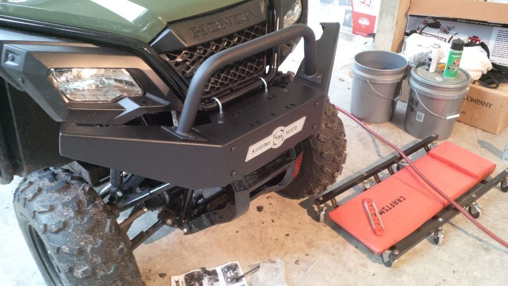

Now with the top bar on the bumper

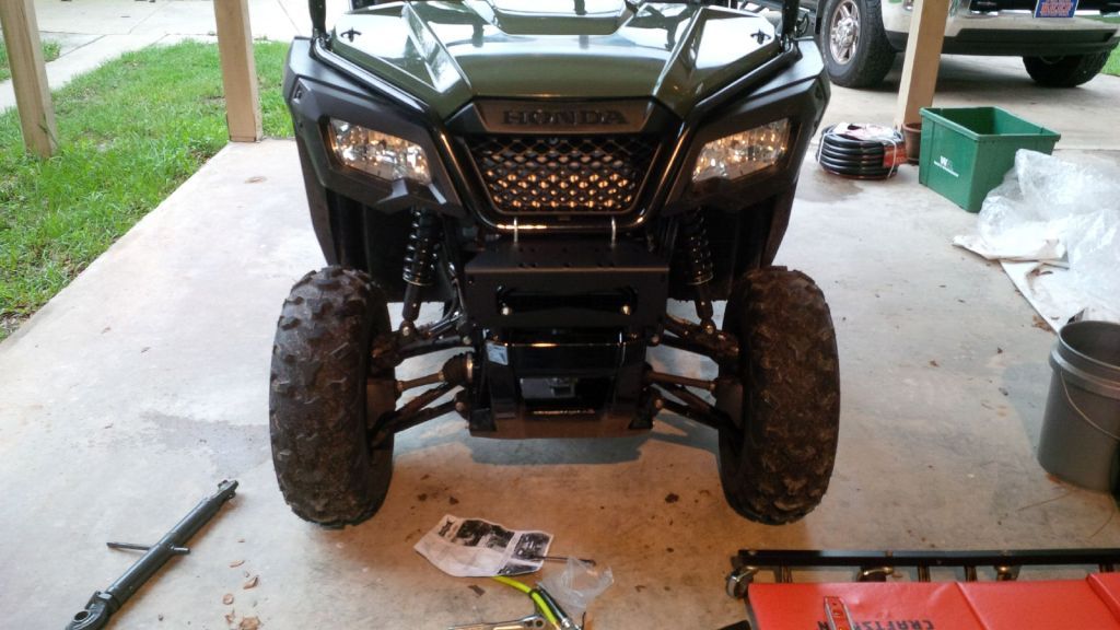

Doesn't stick out more than 1/2" more than the stock bumper
Complete! Now time for a winch/hi lift jack
