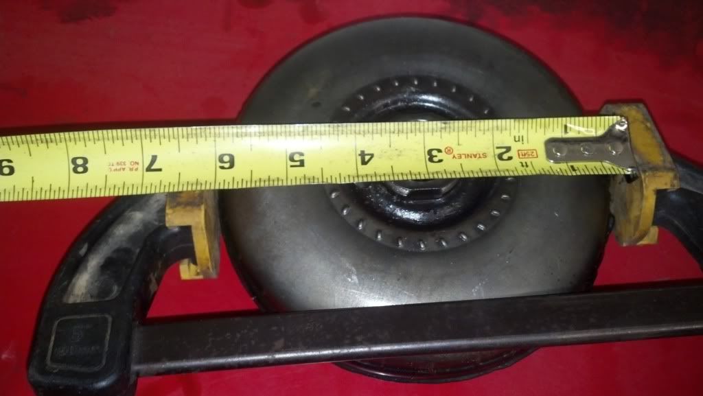

The picture below is a pioneer torque convert, it is hard to tell the actual size but it does look like it would hold a fair amount of oil that would probaly never drain out. It does look very similar to a car.
