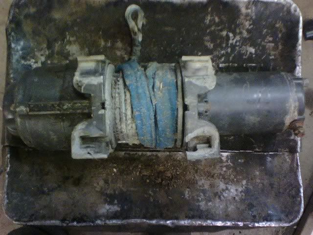

That pot metal almost looks like plastic. Cheap is good sometimes, others its just not the best idea. Same goes for log chains and straps for rigging or towing.
Well said.
There are times when cheaping out is fine, but when it comes to something like a winch that has to take on serious tension, i would go with some well built product, worth the investment
On the winch above the cable spool jumped causing the problems. In the past I have seen it on many brands of winches but now days most of the manufactures fixed that problem.
